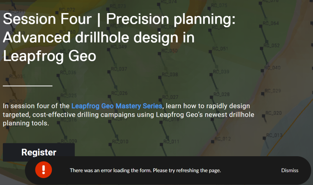

    Sorry, I'm trying to register, but I keep getting an error. I've tried refreshing the page, but it doesn't work. Is the registration closed?
  • HollyChapman
    HollyChapman Posts: 26 mod
    Hi @DeyaneiraOrtiz - thanks for letting us know. I can't recreate your issue right now but am having our technical team look into it.
    In the meantime, I can get you registered in the back end. I'll send you an email to get your details.
    Thanks for your patience!

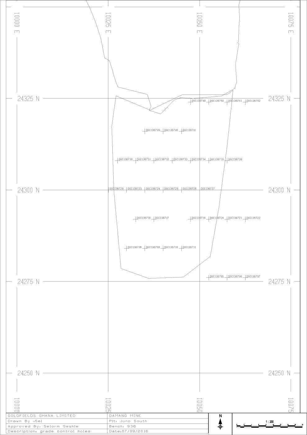

  • Hi Shaun,
    Sorry I could not join the mastery session online, but have watched the recorded video.
    We do 8m by 5m grid GC drilling. 8m spacing on the northings and 5m spacing on the eastings. Every other northing is staggered as shown in the image attached.
    Please, can this be done in the new update

  • Sorry for the late reply.
    Getting the 8X5 gride is not the issue here. My problem is with the Stagger of 2.5m on the eastings of every even line. Say, if the odd lines start on 8350mE, the even lines will start on 8352.5mE. The pattern forms something like a diamond and not the rectangular shape as shown. Please find below a better example. Thanks
