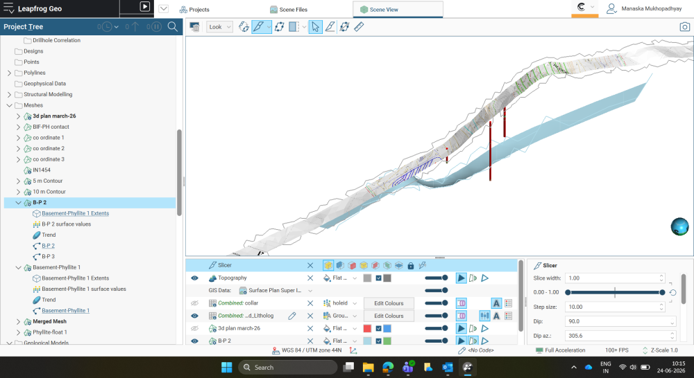

I need a help from all the experts here. My slicer width is set to 1 but the scene is not showing as it should have been. Any help please ??

    Check your drillhole coordinates - this usually happens when you have data spread over too great an area. The usual suspect is an issue in the collar file with a zero or typo in the X or Y causing the project working area to be significantly large.
