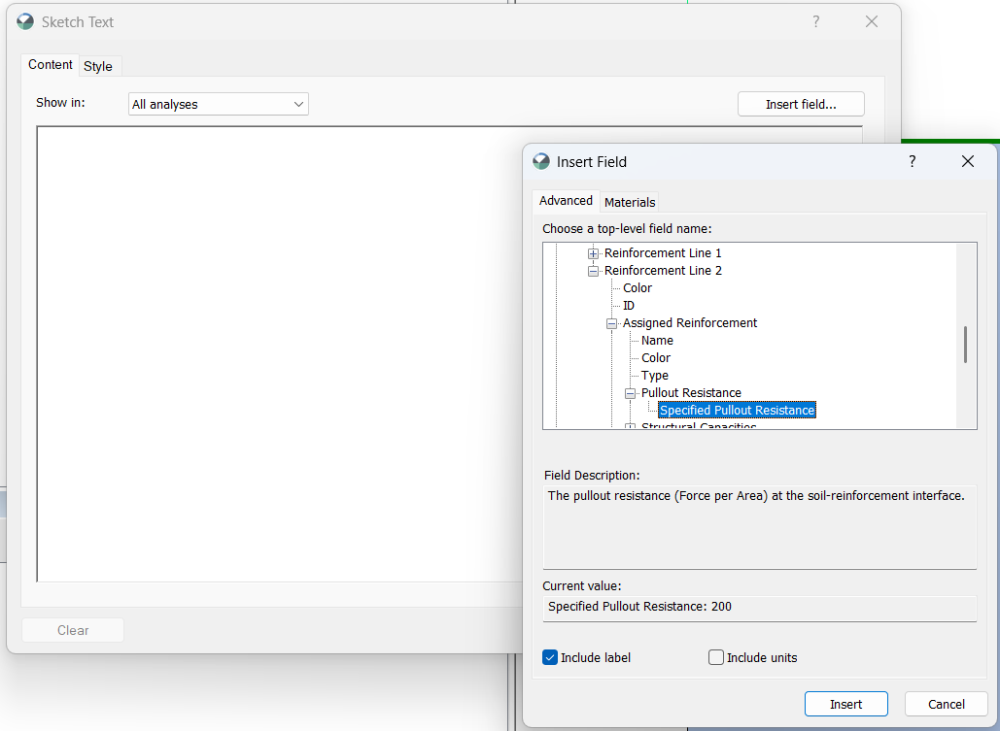

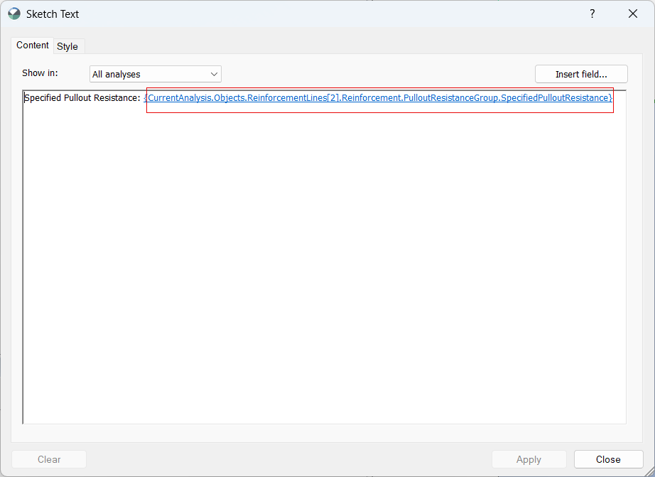

  • Hi @KurtisMiller , while will you are waiting for our documentation/videos, can you try the following steps to identify the 'OC' … object controller.
    1. Open a GeoStudio project file that comprises Reinforcement.
    2. Sketch → Text → Insert Field → find your object and insert the text.
    3. Copy and paste the OC into your python script.
