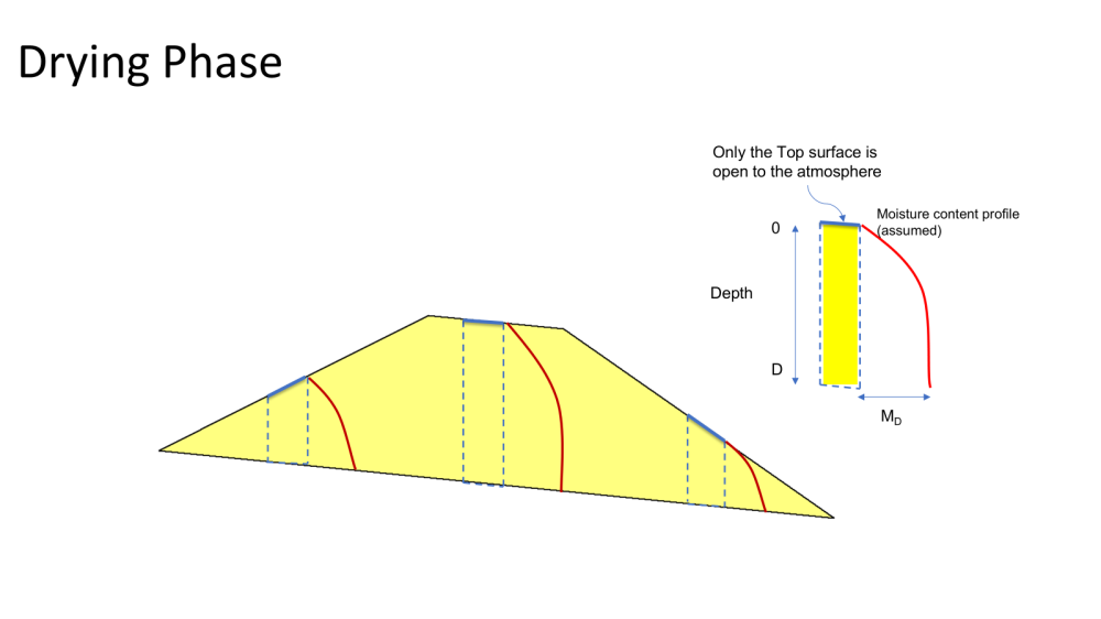

Does SEEP/W under unsat condition takes drying into consideration or somehow we can input initial water content before running storm event on the berm. My concern after storm event the berm goes drying phase between the two storm events. So to run transient analysis how we can input the initial volumetric water content so that the curve starts from reduced initial volumetric water content for the next storm event.

Hello Trevor, thank you for your response and please pardon me that I didn't reply sooner. So to run this I am thinking of running a column test with the same material used in berm compacted to desired density, where the sample will be compacted in pvc mold and to it moisture content sensors inserted placed equally along the mold to note down the temperature spatially after putting it into chamber where I can control the desired drying based on weather. By doing so I can noted down the moisture content along the depth which I am thinking of using it as initial condition. Please let me know if this works or correct way to input in the initial condition in GeoStudio seep w

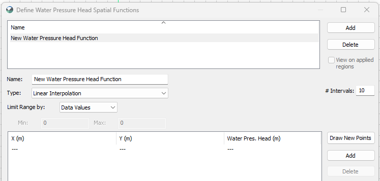

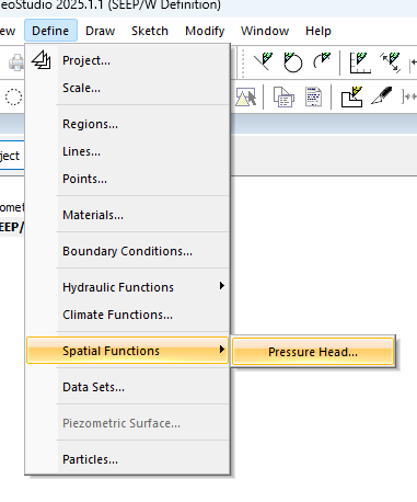

Hi @DivyanshRaunak, you can initialize the domain with a spatial function if that's what you prefer. You can go to Define>Spatial Functions>Pressure Head
Then click Add and you can put in your pressure head data points and select your interpolation method

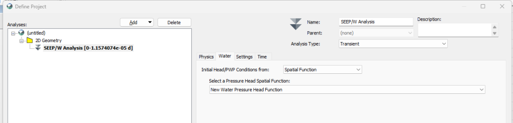

Then you can go to the Define Project dialog and select spatial function in the initial head dropdown, and select the spatial function you defined under that.
