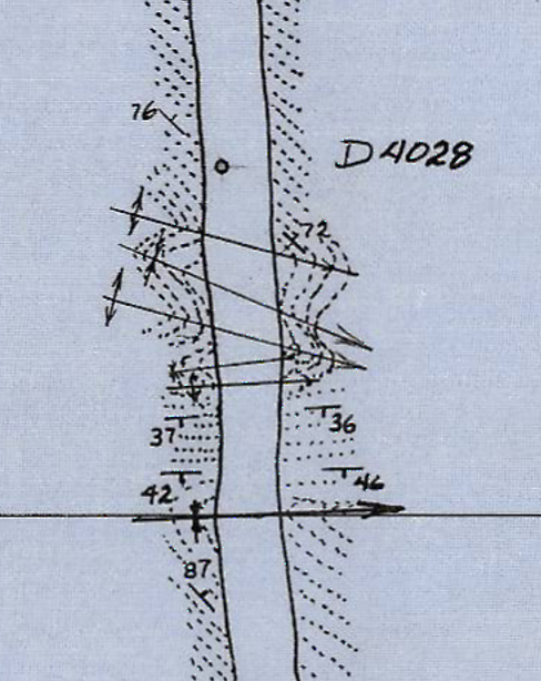

I've got an historic map with oriented lines indicating fold hinges and a dip for each line. What's the best method to convert these lines into accurate structural data?

    When you say you have a dip for each line, do you mean the plunge of the fold hinge, or the dip of one of the fold limbs?
    Can you post a copy or sketch of the map?

    Thanks @GrahamAndrews! I've attached a typical section of the map I'm working with. The hinge lines are drawn on the map, but no other orientation data. Some of the hinge lines do have a plunge measurement, but not all. Any help or suggestions would be appreciated-thank you!

    This looks like an opportunity to use the fold interpolant tool in Leapfrog [Form Interpolants]. The amount of dip & strike data you have for the bedding/foliation is enough to adjust the structural trends of the interpolants, the same with the plunge direction arrows you have. Because your fold axes are fairly close to parallel, so they can share the same general structural trend.
