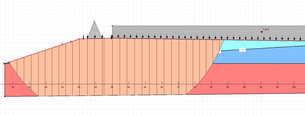

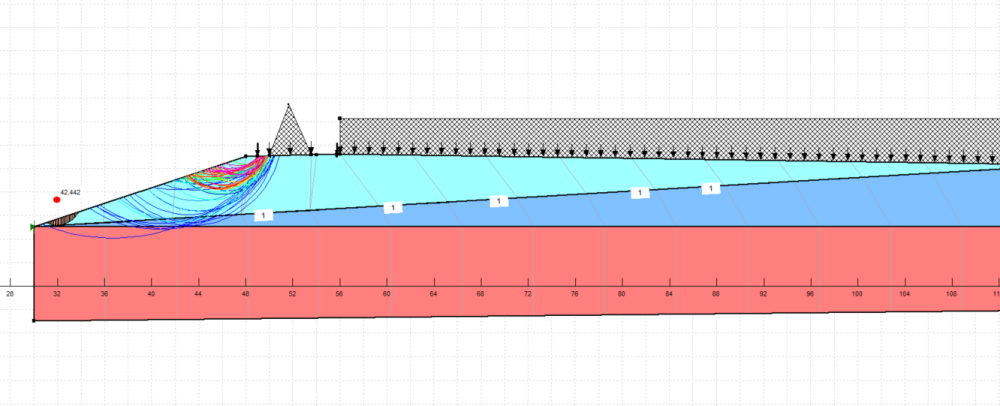

Above analysis in Slope/w version 2025.02 with selecting Automatic slip line, FOS = 42.442
Above analysis in Slope/w version 2025.02 with selecting Entry and Exit slip line, FOS = 7.919
Automatic Slip line gave FOS 5 TIMES HIGFHER!!!

I suggest you learn some introductory cases through the Seequent Learning Center. I have already provided the possible reasons for this issue in another reply.
0 -
Hi @SanjayShukla, both of these FS values are very high and I suspect there may be an issue with your inputs. You can open up a ticket here and attach the model so we can take a look:
