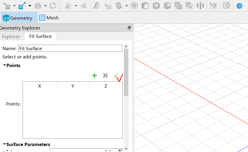

  • Hi,
    If you have a license for the 3D module, you can import CSV or XYZ format files via the built-in data point import function in Build3D, as shown in the figure below. This allows you to create a 3D ground surface model, from which you can then select the location for a 2D cross-section.
    If your data uses latitude and longitude coordinates, you will need to convert them to XYZ coordinates. This can be done using GIS software. If you have further questions, feel free to leave another message and attach your data point file.
    Kind regards,
    Walter.
