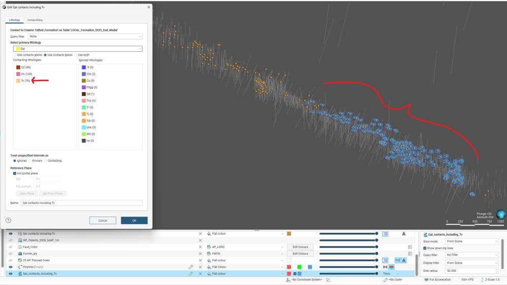

I am trying to model stratigraphy from structural disks because disks are editable and not tied to (or affected by) ODBC refreshes. I create points by Points → New Points → New Contact Points. Then I create structural disks from those contact points by Contact Points → Estimate Structural Data. During the step of creating those disks, LF fails to create disks for all the points. Sometimes, it will only create one or two disks, or maybe the southern half of the disks, or the northern 1/5th of the disks. I seem to get different results depending on which units i "ignore" or utilize during the point creation process. In my photos, you can see that utilizing the Tv unit creates a different result from ignoring the Tv unit. There is come consistency - if I repeat the point generation procedure and structural estimate disk creation exactly the same each time, I get identical disk (abet incomplete) generation.
