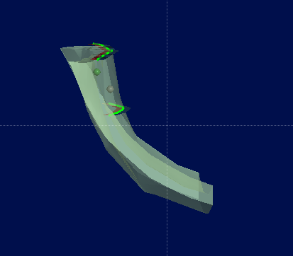

Why are my vein models curved?
I am modeling a series of dykes using Vein System, my inputs include both drillhole data and poly lines.
Why are the shapes curving outwards below the last polyline? How do I prevent this? I want the models to have a relatively linear trend along the dip.
Not all models in the vein system are generating this curved morphology.
Best Answer
Have a look at the Reference Plane for these curving veins. You can change it's orientation by adding other points or even just set it to the plane you want. is it possible there is another data point at depth causing that curvature?
2
Answers
The reference plane was set to horizontal for some reason, this fixed the issue. Thanks!
0 -
I think when you have only a few vein intersections that are around the same elevation the reference plane sets to horizontal. I have had this happen to me too. Glad to be of help
0
