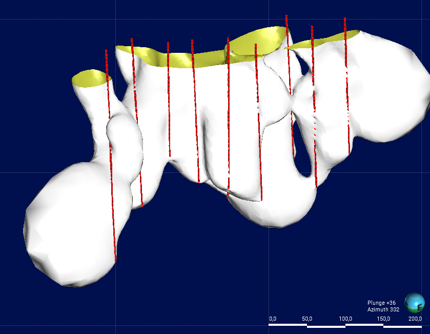

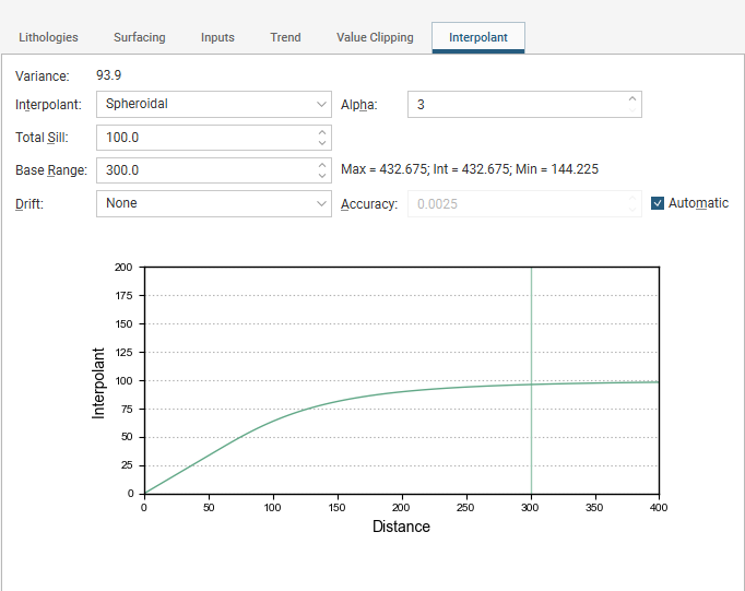

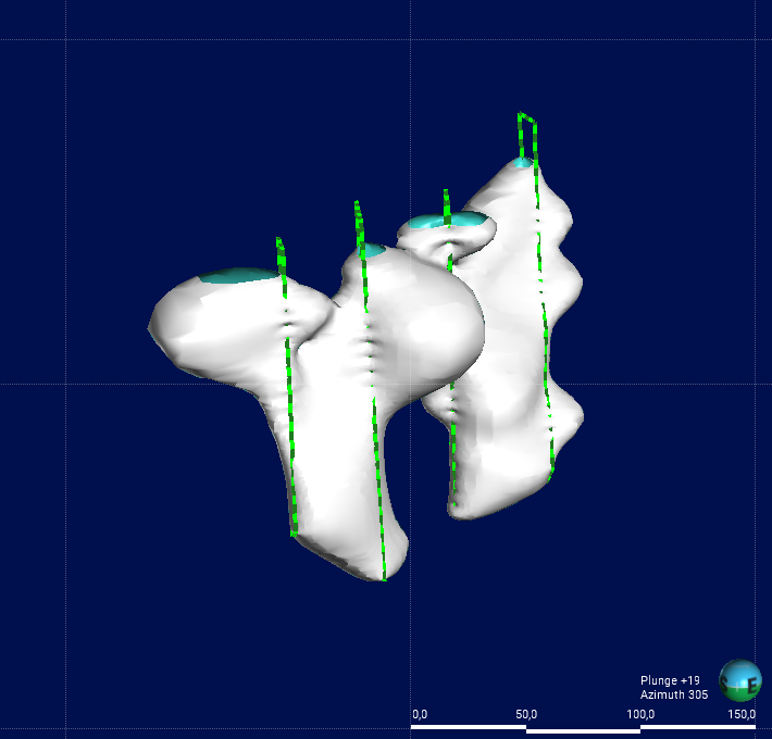

Hi all,
I was modeling intrusion domains using drilling data and polylines contours. Now many of the outputs came with the wrong form, i've tried to change the parameters but still the sale problem (see attached exemple)
If anyone can help please.
Thanks in advance.
Dalla

    It's a bit hard to see what is going on without having the drill data there, but here are a few points. Firstly, intrusion-style models are bad at creating shapes when the overall geometry is tabular (thickness is narrow compared to the other 2 dimensions). In this case Vein models are far better.
    You could try making a structural trend to better control the shape and also check you have snapping turned on for all objects. Also play around with the Value Clipping - if you reduce the influence of 'outside' (negative numbers) that can help with filling in some gaps between data.

    Thank you for your support. The value clipping manip worked very well. And as you said the vein are far better when the intrusions have some particular shape.
    Best regards☺️
