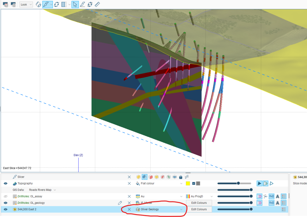

There is a display option for this in the shape list below the main scene. Click on the dropdown arrow on the cross section where it currently shows the layout then select the geology (or similar) from the list of options as shown in the attached screenshot. This will get rid of the white areas.
Let me know if this helps or not.
Peter
