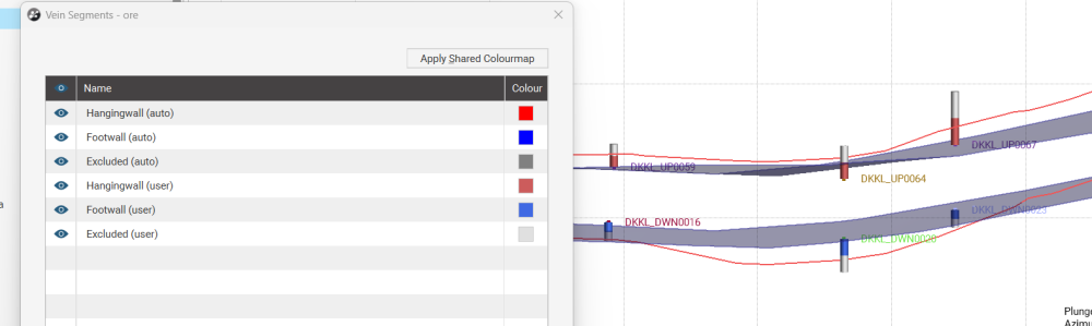

How to modify the hangingwall and footwall to generate the vein?
rongzhuguan
Unconfirmed Posts: 1
in Leapfrog
How to generate a vein using the Vein Segments function, where the hangingwall and footwall of the orebody are controlled separately by underground drill holes?
Tagged:
1
Answers
Hi,
Try to export your hanginwall and footwall as points and generate surfaces with them. Otherwise, put control points or lines where you need. It's a beginning, I hope.
Regards
1 -
No need to generate manual control points here. Bring the vein segments into the scene view, and start editing them. Using the selection tool assign the corresponding drillhole end to hangingwall and footwall, and make sure the ends pointing to the insed if the vein are excluded. That sould give you full control while still being linked directly to your primary data.
