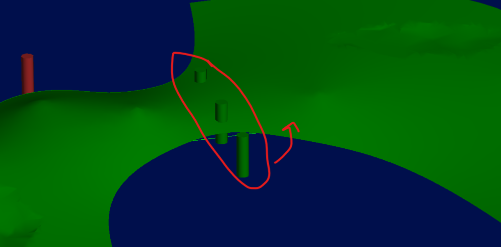

Hello. I've created a vein from a base lithology in a drillhole dataset (green). I had to manually add a number of historic drillholes as a different drillhole dataset, but want to combine a unit from these drillholes to the vein. Is there a way to make a vein based on 2 different base lithologies from different datasets? I don't see any option to.
In the image below, the three circled drillholes belong to my "SH" drillhole database. The vein is based on essentially the same lithology setup in the "BH" drillhole database. I want to make the vein based on both these datasets.

The answer above is an excellent one, and absolutely where I would start. The only other thing I might add is that if the number of historic holes you need to work with is low, then you could just add some points using the polyline tool to the HW/FW ends, and add those to the appropriate surface.
