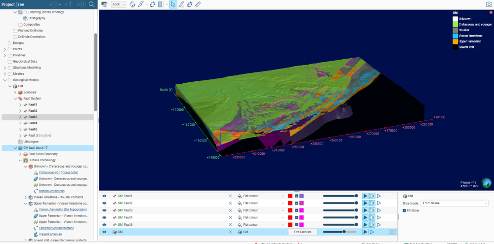

I hope someone can help me with this. I have been given a regional geological map that I have to reinterpret locally to be more accurate to new BH data.
This model has 5 main geological units, but I want to be more accurate and define different sub-units (with particular characteristics), resulting likely in 11 units.
This model has been built with 5 faults, and therefore 6 blocks. The information these blocks (and the model) are using to build the volumes are the topography, structural data, points and polylines, if I am not wrong - I attached a screenshot.
Considering all these, how is the best way to reinterpret this model/these block using the given data?

Hey RG, what you are asking is quite broad, and could be interpreted in different ways. None of the answers are going to be a couple of paragraphs that you can take from an answer here and easily use to achieve your goals, but it is great you are reaching out for help. option 1, if you want subdivide your EXISTING solids (think about going from a stratigraphic formation to a unit or member), is to create a refined model and build inside them. Option 2, if you need to essentially throw out the existing solids and build different ones is just delete them and start over, and build a new model. Now, this is all assuming you don't need to to edit those fault blocks you mentioned. If you need to add or remove fault blocks (not just edit the fault locations) that becomes a potentially tricky change management process that needs to be handled carefully as bits of the model can delete themselves depending on what decisions you make.
