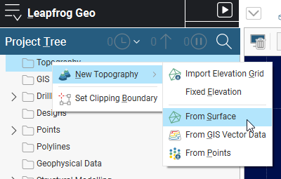

    You should be able to import the .dtm file into Leapfrog as a mesh. We have a useful page here which I refer to often, that lists all of the import and export file types for Leapfrog Geo: Leapfrog Geo Supported Data Types & Formats
    Once you have imported it as a mesh, you can then create a topography from the mesh. To do this, you can right click on the Topography folder in the project tree and choose New Topography > From surface
    In the dialog that opens, you can choose your imported mesh as your topography, give it a name in the next dialog and the topography will be created.

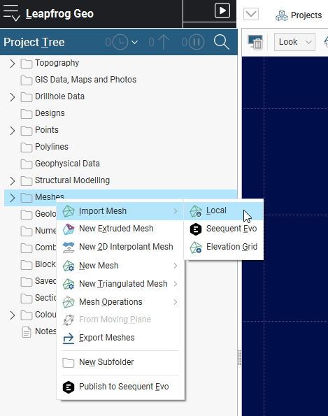

  • AnnabelPardoe
    AnnabelPardoe Employee Posts: 18 Staff
    Sure thing :)
    You will need to right click on the Meshes folder in the project tree and choose Import Mesh > Local.
    Then you can navigate to where you have your .dtm file saved.
