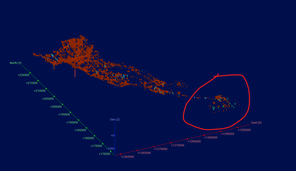

In Leapfrog Works, is there a way to perform a spatial filter on the fly? The objective is to quickly reduce the number of objects in the Scene/View such that when I pivot/rotate/pan/zoom around the screen, it is better focused on the particular area of current interest (e.g., see the screenshot). Thanks for the input.
