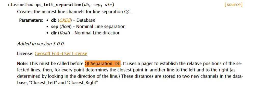

For example. I see in GXDU documention that there is a method called qc_init_separation that seems to have something to do with line separation QC and then there is a reference to QCSeparation_DU:
So I made (or AI at least) a piece of code that goes through every class in gxapi and gxpy and trying to find method called QCSeparation_DU without success. Where is QCSeparation_DU located?

QCSeparation_DUIspecifically, I can confirm that is a mistake in the documentation. There is no such method, and I can tell you that that note is likely a mistake and reflects an older version of the API. qc_init_separation has a C++ equivalent called QCInitSeparation_DU that is usedqcsep.gxcwithoutQCSeparation_DUI1 -
