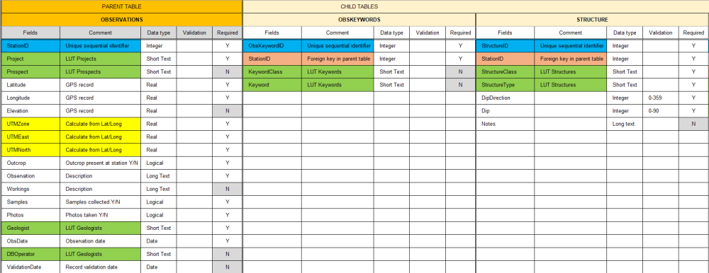

Hi @DavidKerr1,
I've attached a screenshot of the database design for our Field Observations. I originally set up a parent-child table structure in QGIS for use in QField, which prompted my initial question about unique identifiers for replicating it in MX Deposit.
However, I've since realized that MX Deposit child tables don't require explicit unique identifier fields, as headers and tables can be configured directly within the Activity settings.
For my learning, I would like to know is there any function to generate unique identifier fora chosen in MX Deposit?
Thanks.
0 -
Could you just use the "point number" string value as your StationID? That's your primary key in the main table, and the foreign key in the child tables. You'd have to change the data type - but if you just keyed off those values, then you could use MX Deposit exports as is.
Everything in MX Deposit has unique identifiers, but they typically aren't exposed in exports. Rows in tables (your child tables) do have an "ID" value that can be exported - and this is effectively a GUID. So you could pull that out and use that as your primary keys in your child tables.
