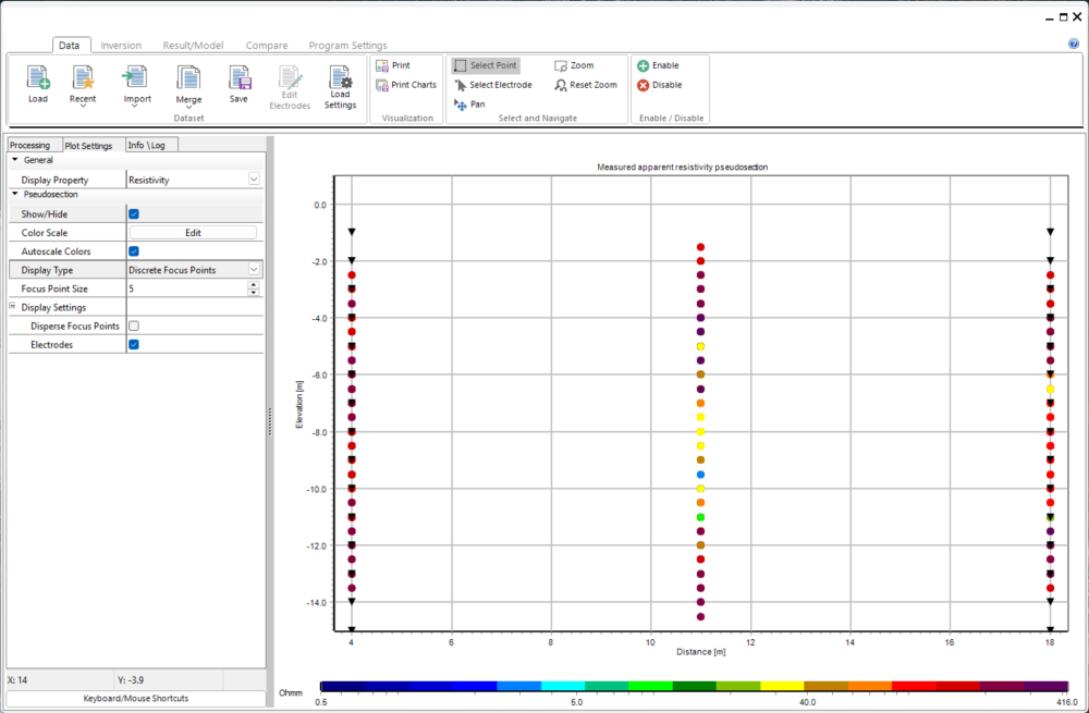

Quick feature shout out that I have been using daily. When I bring borehole data into Res2DInv, I use the Disperse Focus Points option every time.

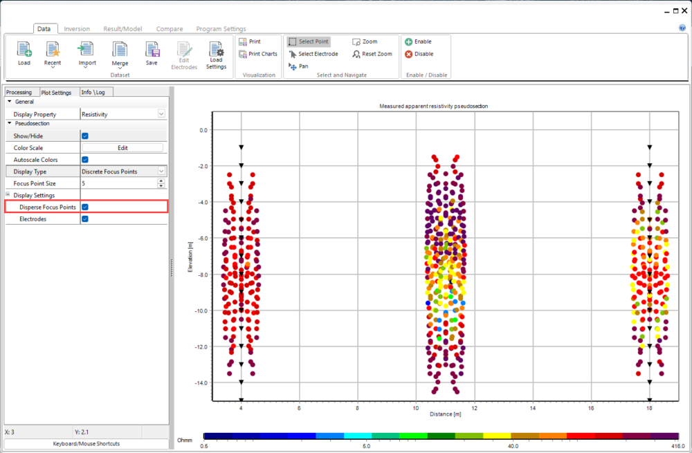

Even if you have only one borehole but focus points are landing in the same spot, this setting visually spreads them out so you can actually see and work with the overlaying data more easily. It's purely visual, it does not change the model grid or affect the inversion at all, but it makes QC and interpretation so much less frustrating.
🎉It is one of those small quality of life settings that makes working with borehole feel way cleaner.🎉
🔎Find it: Data Tab > Plot Setting Pane > Display Settings > Disperse Focus Points
