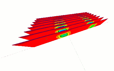

I am currently working on a Res2DInv Fundamentals course and while playing with inversion settings on a bulk inversion (8 lines simultaneously!!), I discovered a new-to-me feature!
I loaded the eight 2D lines into the 3D viewer and for a second panicked as I realised I hadn’t added the global coordinates yet (😫). So, I figured everything would be jumbled on top of each other.
🙌Turns out the Offset Position tool saved me! 🙌
It let me set the line spacing directly in the 3D viewer so I could quickly line everything up and get a decent sense of the structure before re-running with different inversion settings! It also helped me visualise how the sections connect spatially.
Has anyone else been saved by the offset position tool in this way? Or have you used it in other ways? I’m already scheming up ways I can utilize this feature - upload the same line with different inversion settings or different models… 🤔
