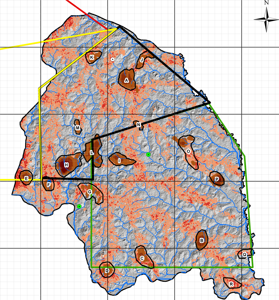

I am currently conducting a study focused on identifying potential alluvial gold targets, particularly placers, within an area ranging from 1,000 to 10,000 km². After analyzing existing data related to artisanal mining activities in the region, I found that the number of recorded sites is insufficient given the vastness of the area. To complement this approach, I made use of remote sensing, particularly the analysis of satellite imagery, which enabled me to highlight several potential placers and to define prospective zones. However, since I do not yet have the necessary equipment and I am not entirely certain of the most appropriate method to carry out small-scale gold prospecting, I would like, given your expertise, to seek your advice on the most suitable approaches. I sincerely thank you in advance for your availability and guidance. I would also like to point out that the identified prospects range in size from 0.9 to 10 km².

  • 1. Target Prioritisation (Desk)
    • Rank by geomorphology (inside bends, confluences, terraces), provenance (upstream Au sources), and ASM proximity.
    • Select top 3–5 prospects for ground truthing.
    2. Reconnaissance (Fast Ground Check)
    • Pan concentrates every 300–500 m along streams & confluences.
    • Collect a few BLEG/heavy-mineral samples for lab confirmation.
    • Hand-auger shallow bars/terraces to log stratigraphy.
    • Upgrade targets showing consistent Au and classic traps.
    3. Evaluation (Map Pay Horizons)
    • Test pits or augers to bedrock on 200 m grid (~25 samples/km²).
    • Tighten to 100 m or 50 m grids only if Au is continuous.
    • Use ERT/GPR for buried channels where pits are impractical.
    • Collect channel samples of pay layers.
    4. Bulk Testing (Pilot)
    • Excavate 0.1–2 t samples from pay zones.
    • Process with simple gravity circuit (sluice/highbanker, blue bowl).
    • Calculate g/m³ and cost/m³.
    5. Decision
    • Advance if recoverable grade exceeds cutoff (e.g., >0.15–0.3 g/m³) and shows continuity.
    • Otherwise, down-rank and shift to next target.
    6. Equipment (Minimal Start-Up Kit)
    • Pans, sluice, classifier screens, hand auger, GPS, sample bags.
    • Upgrade to highbanker/power auger, detector, or small ERT kit if justified.
  • I would like to sincerely thank you, Richard, for the proposal you shared and for the time you devoted to outlining such a clear and detailed methodology. Your step-by-step approach, from target prioritization through to evaluation and decision-making, is truly a valuable guide for me. I especially appreciate the balance you strike between simple, low-cost methods and more technical techniques, applied when appropriate.
